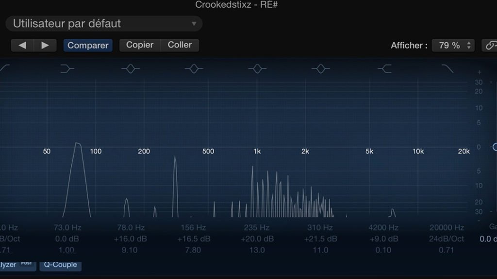

Singing Didge: a didgeridoo that sings
Last December, I started working with Adam, Australian maker of CrooKedStiXz. By the way, he does really excellent work, I highly recommend him. So I received a D# didgeridoo that he had made according to my requests. From the first second I blew into it, I fell in love with this didgeridoo. Do you know why? Because it sings! Listen instead:
Do you hear that frequency that sounds well above the others? It’s (again!) this fourth harmonic that dominates the spectrum.
I amplified it on the same recording so you can hear it well.
Cylindrical didgeridoo in D# by Crookedstixz
Didgeridoo in D#
Fundamental: D# = 77.78Hz
Octave: D# = 155.56Hz
Fifth: A# = 233.34Hz
Fifteenth: D# = 311.12Hz
Third: G = 388.9Hz
Fifth: A# = 466.68Hz
To make sure we’re talking about the same thing, I specify that it’s the amplified harmonic that is the furthest right in the video, the one that vibrates at 310Hz. It offers a warm presence to the didgeridoo.
We’re dealing with the same pattern as Alex-didg’s C didgeridoo and Bob Druett’s D (both tested above). However, the fourth harmonic is particularly present in this D#.
I always say that such a didgeridoo is an instrument that sings, and believe me, they are very rare to find. Indeed, few people pay attention to this and therefore makers don’t necessarily focus their research in this direction. Most of the time, we seek power at the expense of these fine frequencies.
